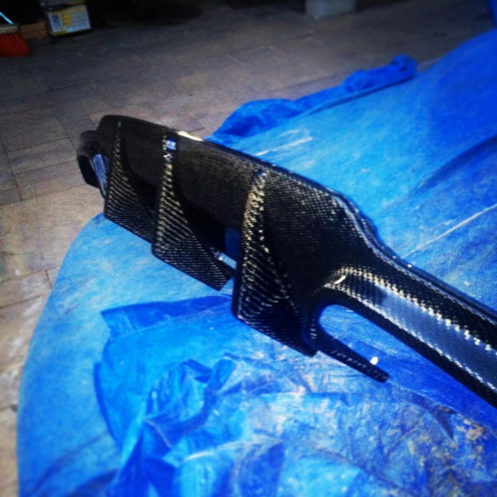

- Revozport RBSII Big Fin Diffuser with Ground Effects Panel
