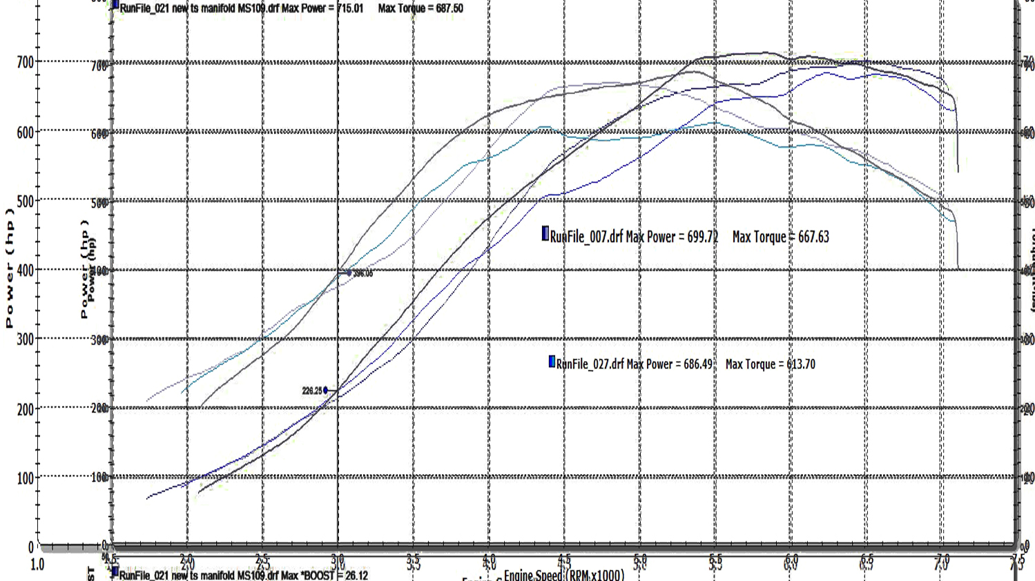

Thing is working, and working well. That dyno is very comparable to our Stock Frame 700WHP dyno, not bad for an older GTX35R, on 109. That really is great spool, and power for 26psi. Overlaid it just for fun. Curves are remarkably similar, but that thing is making smooth early power. 686 graph is with vanos tuning the 699 run has OTS vanos. This is a great example of what a properly set up 700WHP E9X should be running in the 1/4 mile. Mid 10's at 140MPH.

So the point is? As this is essentially a good flowing log style, and as is the manifold you guys sell. The point is, lots of internet experts to pick shit apart, when the company actually invented that manifold design, and has been making them for years. This thing will work fine. I do not think its ideal personally, but everyone is a shit talker on the sidelines, while building nothing themselves. Obviously not you J. You have done as much as anyone to push this platform forward.
Have to agree with you. That spool caught my eye for sure. Just for fun, speaking of twins, here's ICS twin GT3076r e36, 1142 WHP, friggin' nuts. 223 MPH standing mile with LESS power:
