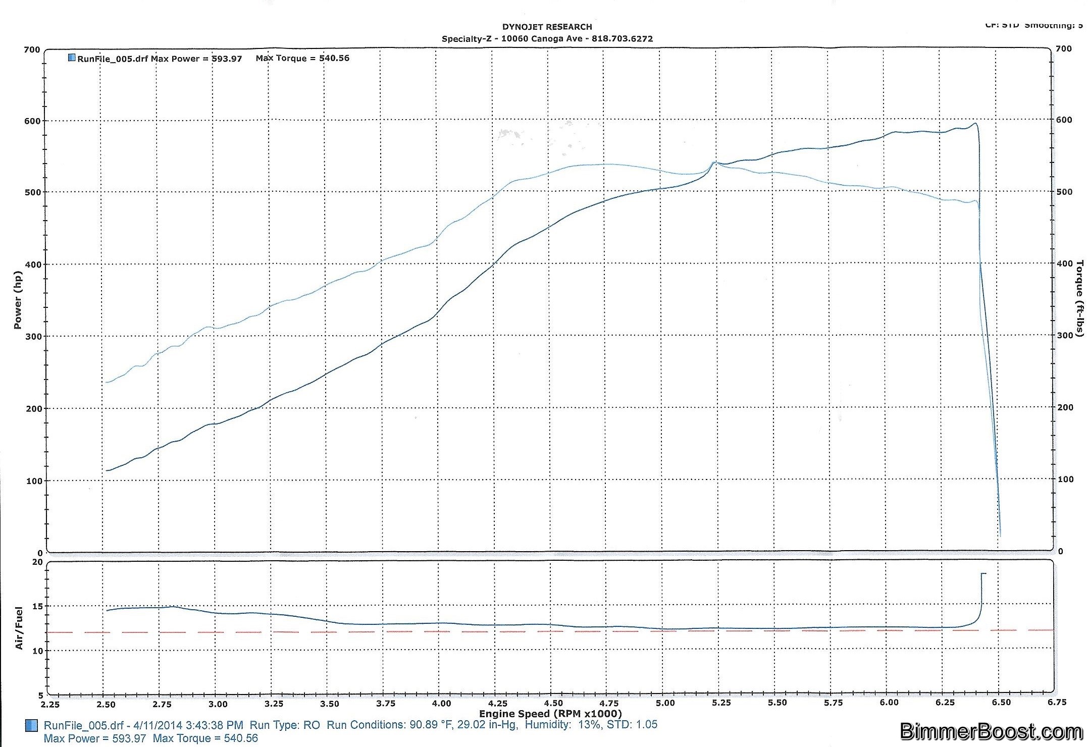

It is on par with all other kits in terms of power with similar sized turbo and fueling. Spool will always be an issue when going to bigger sized turbos like this. We are using a bigger exhaust housing AR than most would consider but it is not too large.
Low end torque is great and starts off about 1k rpm sooner than other kits with similar sized turbo. Spool can be maximized with better exhaust as well. Here is the log from the dyno run, 5th gear.
Attachment 38688
