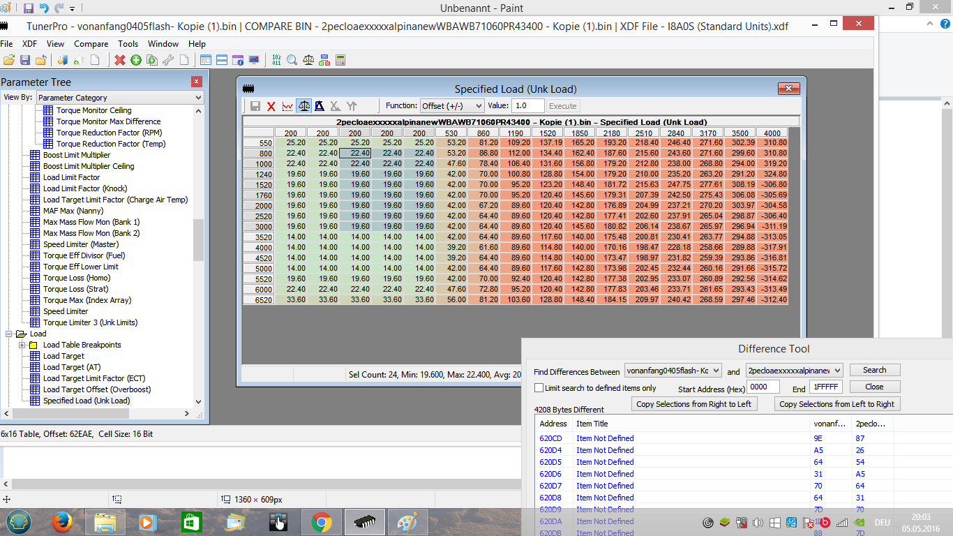

this is a mixed map from bms cobb alpina ppk and 1m
you should use mhd flasher
  • martial@mhd's Avatar
    martial@mhd -
    That's a i8a0s file.
    What torque tables do you know that are missing in the xdf? That would be a good contribution to share that.

    Attachment 49213
    can some 1 tell me why this flash map is going on the -direction
    saw that on the other tuners flash ?? have some one a clue??
  • jyamona's Avatar
    jyamona -
    Quote Originally Posted by wowprcc View Post
    Attachment 49213
    That table is a waste. It is an air target for the engine when cold, in stratified combustion mode, which isn't used.
