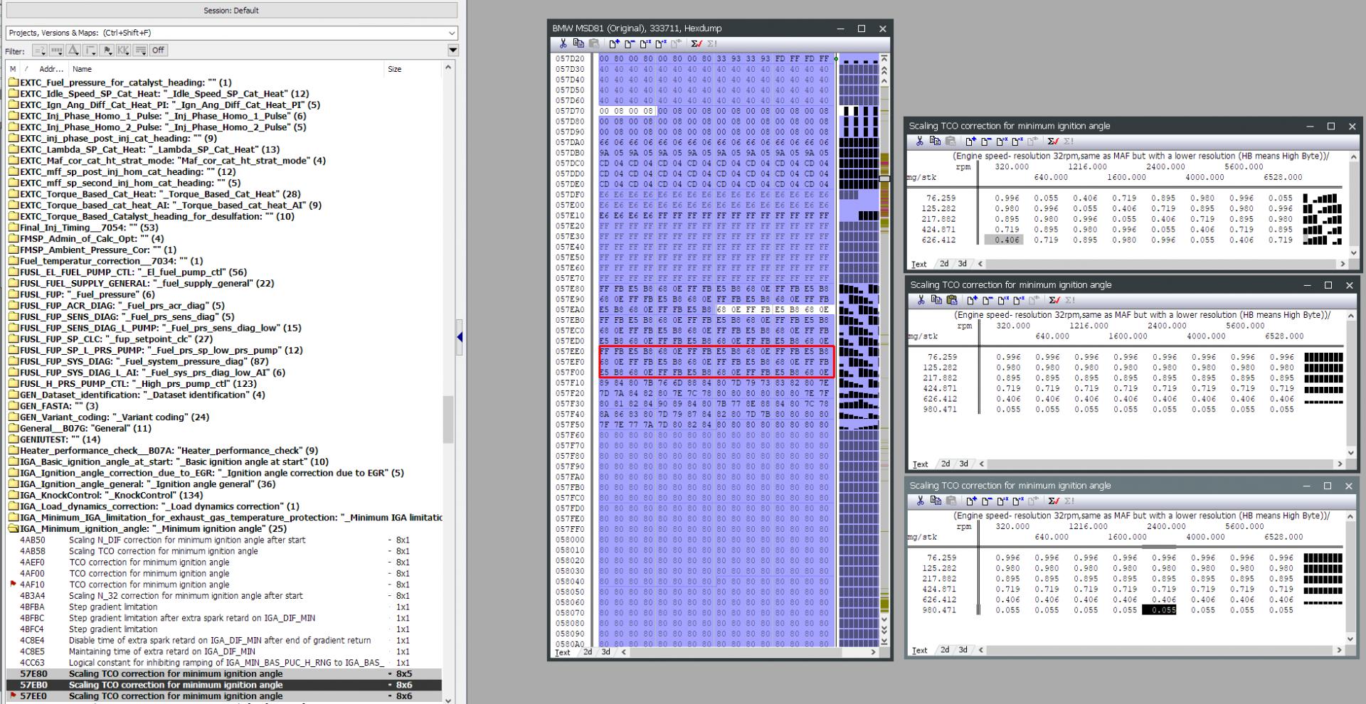

    Hey @CarAbuser, Why are you grabbing from what appears to be the middle of a 6x24 table for "Minimum Ignition Angle During Trailing Throttle (Factor)"? Your table starts at the curser and ends 8 bytes short of the end of the table.

    I'm not, it's three tables stacked on top of eachother. Attachment 59950

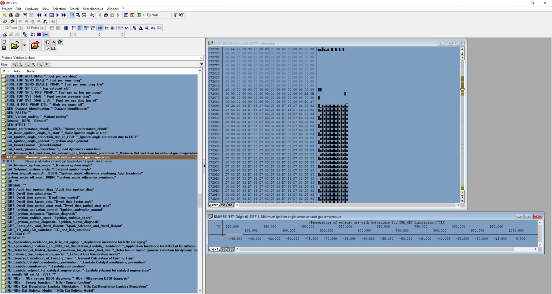

    You also may want to adjust the Min Ign Angle Vs EGT table. I don't quite understand or even want to learn how the DME calculates egt but it does have a way of limiting spark retard when it gets too hot.
    Imagine the pops (or engine damage) at negative 80 degrees of timing lol
    Many of the ignition tables have the ability to go all the way down to -90.
    Attachment 59952
